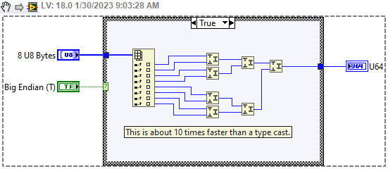

The Type Cast is the correct way to do this.  However I've seen performance is slightly better with joining of values.  I didn't test the performance with shifting.  When I do conversions like this I call an inlined subVI.
This is what is used in my Frame Signal conversion library.
