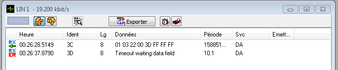

Besides, when I check the Mux Trace to see what the ndUDSReadDataByIdentifier send on the LIN, I see this :
but what I want to send is different. I mean, when i call the ndUDSWriteDataByIdentifier function.
