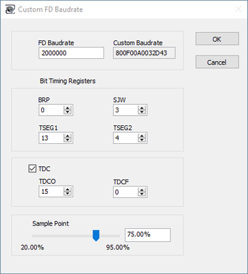

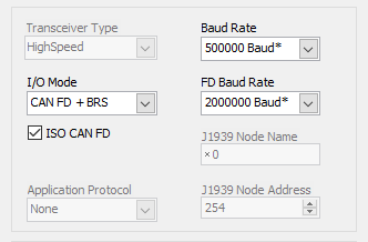

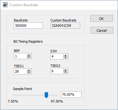

I've the same problem, but the attached vis don't give the same solution as XNET Bus Monitor... I work with XNET on a CAN-FD bus. I've 2 baudrates to configure: 500k and 2M. My goal is a sample point of 75%. Playing with only Baudrate value and sample point I obtain 0x800F00A0032D43 fo 2M/75% and 0x32A0041C09 for 500k/75%.
I'm looking for a vi to convert 64-bits baudrate and sample point into a custom baudrate, exactly like the screenshots of xnet bus monitor. Do you know if this king of tool exists? I've tested all the vis of this discussion without success...
It will be clearlier for the final user to configure directly baudrate and sample point instead of use other tool to obtain custom badrate and report it in the final application...
Thank you per advance!
Francis M

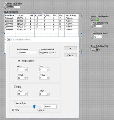

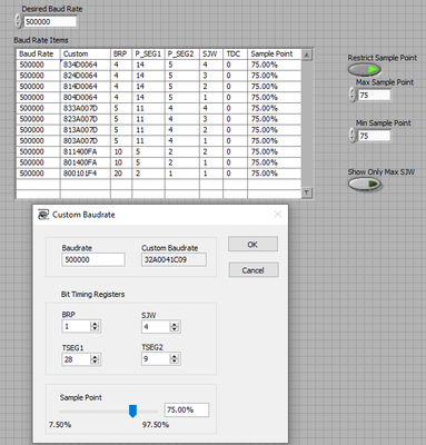

Because of how the timing parameters work, there will often be multiple correct answers to a single baud and sample point.  Using the VI NI posted here I put in 500k and a 75% sample point. It found 11 combinations of the timing parameters that meet those requirements.  If you use the Show Only Max SJW then you still have 4 different timing parameters that meet that requirement.  Keep in mind this is for the 40MHz frequency. I think most or all NI hardware use this.
My point is that The XNet window you show will only show you one valid solution, and it might not be one of them that the tool came up with.  If you have only a few known rate, and sample points you use, then maybe it would be best to just hard code those.  When the user wants 500k at 75% just use the constant the XNet tool gives you.  If you want to have a UI where the user picks the baud rate and sample point, then you can use NI's tool.

BUT I don't understand why the CustomBaudrate proposed by XNET Bus Monitor doesn't appear in the list populed by the vi... I would imaginate that the "NI default" value" should be in the list... In my example, I use a CAN HS/FD Interface USB-8502.
 Why the lis is not complete?
Francis M
