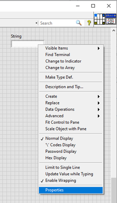

The right-click option "Add Event Support" does not appear when I right click on the newly added actor core front panel object.
I created a new project, and use the Tools>Create Actor from Template to create a new actor.
I then added a string to the actor core.vi front panel, saved the whole project and then attempted to right click on the newly added front panel string and select "Add Event Support" but the option does not appear.
I am using LabVIEW version: 18.0f2 (32bit)
I have also tried reinstalling package, restarting LabVIEW and even restarting my computer with no change in outcome.
Any thought as to what to try next?

Try adding an Indicator to the front panel.  The right-click option doesn't appear if you add a control to the front panel.

Hi Jake77,
That's expected behaviour, typically we would only use user events to update indicators. If you want to update a control's value, I would suggest using VI server (property node) assuming you're only updating the control value once every so often.

Anyway installed with LabVIEW 2020 32 and 64 bit and while the Tools>create actor menu item is under tools, I can't see it when I right click a control on the actor core.
Any suggestions? - OK placing a new indicator seems to work. However controls copied across didn't work. Seems a bit weird.

Hi Nick,
The RCM will only appear for indicators. Typically we use user events to update indicators, if you want to update the value of the control I would add the control reference to the actor private data and use a property node.
