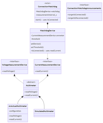

@WavePacket,
Having just read that more messages were posted while typing this, I am likely repeating what cbutcher wrote. You may need to consider abstraction at the highest levels of your problem domain (your test stations?), and set up actors at those levels. This way, the interfaces implemented will all be meaningful for each domain.
Your problem-domain specific actors each will be composed of an abstract class (as Sam Taggart initially recommended). Each abstract class (i.e. adapter) will expose only the application-specific APIs for your corresponding hardware class, again via composition. The hardware class (not an actor) will still be full-featured, reusable across problem-domains.
Regarding database, it is, to me, another concrete entity whose implementation is to be abstracted out (yes, that word again) based on your problem domain. You may be referring to the same database for multiple purposes (system configuration, user management, test results), it doesn't matter - you would still need to abstract those purposes out at the problem-domain level. In other words, separate abstract classes for each intention - load/save configuration or manage users or log test results.

@WavePacket wrote:
I'm trying to understand your reply. Using the specific example (link) mentioned before, let's assume that I have a test measuring just current, but it uses a physical multimeter that can measure more than just current. In LabVIEW the multimeter is a class, and the class inherits from an interface corresponding to each measurement the device is physically capable. Is your suggestion:
  • have a test software actor, that test software actor via composition owns of an abstract class
  • that abstract class would be composed of just the current interface
First, do I understand your suggestion right? If I am, what does this get me over just having a test software actor composed of the current interface? That I'm asking that second question likely reveals I'm rather green at the concept of "adapters".
In the case of the test where your need is only a current measurement from a multimeter, you may not even need an actor. To illustrate where an actor may be warranted for the same interfaces and devices, consider this hypothetical scenario: Your application needs a watchdog to ensure connectivity of your target device. One way of doing that is by continuously measuring current flow through a particular point. If measured current exceeds a threshold, then the target is deemed connected. The class diagram below may give a clearer picture.
Here, ConnectionWatchdog class is the only actor, which will be used as a nested actor. Connection can be checked at configurable intervals. If connection is established, targetIsConnected message is sent. If connection is lost, targetIsDisconnected message is sent. It encompasses a WatchdogDevice, whose only requirement is current measurement from any device with that capability. The decision to use a Multimeter or not, is up to one's implementation needs. The key takeaways I wish to point here are
  • The caller actor launches and activates ConnectionWatchdog actor without explicit knowledge that the latter is using a multimeter internally.
  • The caller actor implements ConnectionWatchdogAnnouncements, which is completely problem-domain specific, even though they may be implemented through current measurements.
  • The devices themselves do not need to be made into actors just to provide their measurements.
  • Well-defined actors have a clear raison d'etre within the problem-domain.
I have successfully used a similar concept in a track-and-trace application; where freshly printed barcodes on production units need to be verified in-situ. From a problem-domain perspective, my requirement was to visually verify an array of expected barcodes. Here, the actor is (amateurishly) called ScannerActor. Upon being asked to verify a list in each call, it produces either of two 'announcements'. allBarcodesVerified() OR barcodesMismatched(with a list of mismatched barcodes). Upon receiving the first announcement, the caller actor's override is implemented to route all production units to a 'shipping' bin. With the receipt of the second announcement, the caller actor override routes the rejected production units to a 'rejects' bin; and puts the remaining into 'shipping'. The actor itself calls an abstract scanner class to allow for simulation testing with a simulated device driver or live production with a real scanner device driver.
Hope this provides better clarity.
