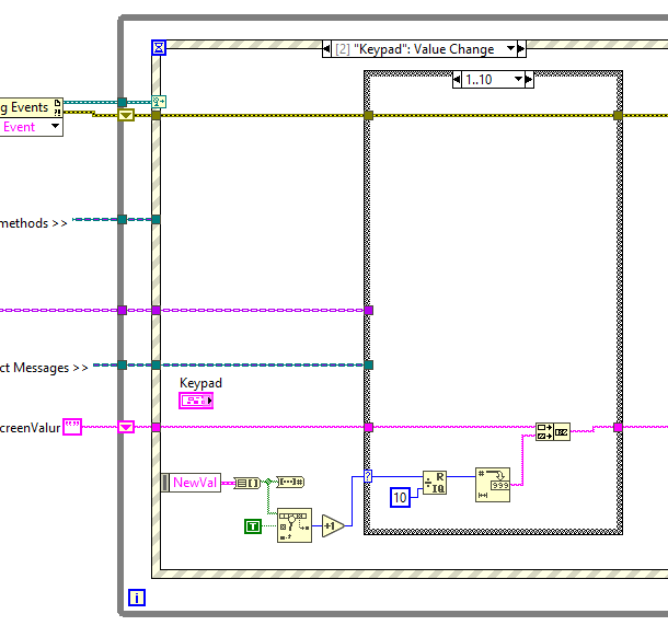

As a side note, the New Value > Cluster to Array > Boolean Array to Number is really clever (I'll keep this in mind next time I want to find the value that changed in a cluster) but the handling code is pretty verbose. You could have done the following instead (I made C element 10 and left E as element 11, making 0 go from 10 to 9 in index):
I had to add a Quotient and Remainder to get rid of the "10" for 0, but otherwise it was fine. I suppose if I made the 0 the 0th element, and then removed the +1, that would be unnecessary (but I didn't think of that until I started typing this...)
