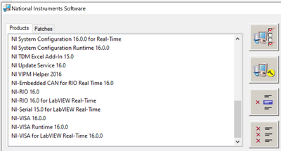

It is true that I removed all the NI software, because every time I reinstalled myRIO bundle, it skipped installing LV2016. Therefore I removed all the folder in the "Program Files (x86)\National Instruments" which I assumed as a clean installation. Anyway I can install LV2016 myRIO bundles, as shown in Figure:
According to MAX, the software that I have installed are:
 It seems that the LabVIEW Realtime and myRIO Toolkit did not correctly installed. When I reinstalled myRIO Bundles, it cannot be installed, as shown below:
However, when using "Setting >> AppS & features >> National Instruments Softwares", it seems that the Realtime module and myRIO had been installed

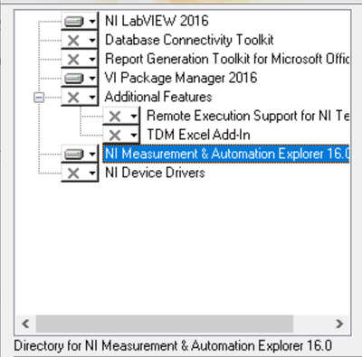

Thank you for your quick respond. I did follow your previous suggestion to install NIPM first and continued to install software bundles one at a time and boot after each installation. I installed each software from "Distribution" folder. While doing installation I got your new suggestions. However I continued installation and it went the same problem ( IP address inconsistent). I realized that I made two mistakes in installation: 1. I forgot to unplug the USB Cable that connected to the myRIO, 2. I installed myRIO toolkit before installing drivers. Therefore, I followed your current suggestions.
I uninstalled all the NI programs using Apps & Features from Windows, but they were handled by NIPM. All the programs gone, but they were many folders and files in the "Program Files (86)\National Instruments". To clean these files and folder I used "uninst.exe /qb  /x all" . But the NIPM was still in the computer, and could not be uninstalled using Windows application. I used third party software to uninstall the NIPM (2020). I do not know whether this is a clean uninstallation.
As you suggest I did not use NIPM, and installed each software at a time followed by booting.
1. Install LV2016 with NI MAX (this part has to be installed with LV2016). Other part can be disabled
This step installation I included VIPM2016
