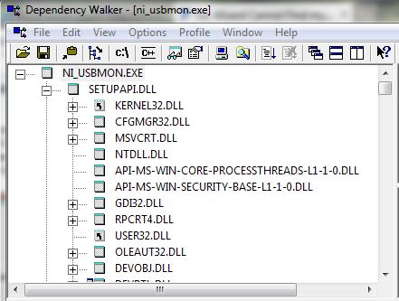

Bonjour service is not related with myRIO software. Perhaps there are other components failing in your computer and the OS is the problem. Try installing the software on a separate computer.
I recommend using Dependency Walker, it will let you know what may be missing from the load process and the process itself is an executable called "ni_usbmon.exe":
Alejandro C. | National Instruments

Installed on a different PC and success!!! So must be OS problem on my PC that I will try to solve.
