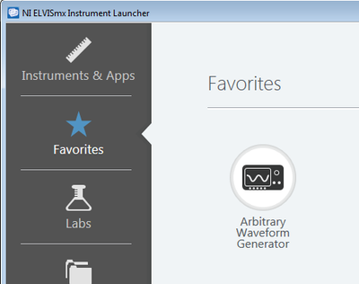

The Favorites page is for grouping items on different pages in a single location. For instance, you could add the DMM and FGen from the Instruments page and a link to NI MAX from the Resources page by clicking the star in the upper left corner of each item. These items would then be added to the Favorites page. So, if there are certain instruments you use more than others and you only want a view with those instruments, you could add them to the Favorites page for a customized view.

The launcher has never been an actual part of the desktop. It has always been a separate application, with additional instruments and resource links when you hover over it. That part hasn't changed. It may have looked like the links were desktop icons, but it was a running executable as it is now. It just had a more compact interface. The new interface is based largely on feedback we've received about the launcher features not being as intuitive or user friendly as we would like.
As for the Favorites, I may not have been clear. Nothing new will show up in MAX. Everything on the Favorites page must also exist on one or more other pages in the launcher. There is an explanation of how to use the Favorites in the NI ELVISmx Help, but I'll elaborate a little here. When you hover over an item on a page, you should see a star in the upper left corner. If you click on this star, that item will be added to the Favorites page. For instance, if you use Arbitrary Waveform Generator most often and would like to avoid searching through all the instruments to find it every time, you can add it to Favorites and quickly access your most frequently used items.
Donovan
