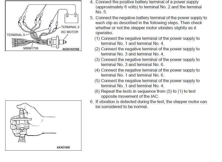

I am working on an academic project to control the linear motion of a stepper motor or also known as idle air control valve (IACV) that is typically found in older drive by cable throttlebody type of vehicles. Unfortunatly, I am not able to find the specifications of this idle air valve (based on 2.0l turbo and 2.4l NA mitsbushi models), so I am curious if anyone can guide me into setting it up through a myDAQ with Labview to enable its actuation.
Attached are some images of the valve (6 pins input) and some trouble shooting images of the vehicle manual I found online.
Any help is appreciated!

Hello CompTurbo,
Here is a good starting guide to connect and control a Stepper Motor with a DAQ device, including VI examples:
https://decibel.ni.com/content/docs/DOC-35115
