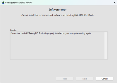

I have successfully installed my LabVIEW and MyRIO Toolkit. My computer can detect the device, however when I launched the "Getting Started Wizard", an error message appeared: "Ensure that the LabVIEW myRIO Toolkit is properly installed on your computer and try again".
I have checked that the LabVIEW and the MyRIO Toolkit have the same version, which is the 2019 version. I have tried the main solution, which is to manually install the software from the NI MAX. However, after clicking on the "Add/Remove Software" button another error message appeared: "Something went wrong getting the installed and available software".
Is there a fix to this problem?

Your software installation appears to be a (possibly incomplete) mixture of LabVIEW 2019, LabVIEW 2021, and other LabVIEW versions that do not support the myRIO Software Toolkit.
It is difficult enough to attempt to install "by hand" the software to support development on the myRIO (though, paradoxically, knowing "too much", as I did, can totally prevent installation of the 2021 Toolkit ...).  I see "bits and pieces" of multiple versions of LabVIEW, but not everything appears to be present for either a 2019 or 2021 "myRIO Development PC".
I thought MAX would tell me, but apparently it don't show (in Software) whether you have FPGA support.  Can you open NI Package Manager and on the first "page" of installed Modules, see if you have LabVIEW FPGA entries (and note the full description, including Version), the LabVIEW myRIO Toolkit (description + Version), and LabVIEW Real-Time Module (description + Version).
My thought is the "fix" is to completely remove LabVIEW from your PC (I believe there's only one safe way to do this, which I'm happy to explain) and reinstall either a LabVIEW 2019 or LabVIEW 2021 "myRIO" LabVIEW system.  The 2019 installation is easy, the 2021 installation is more difficult.  Once this is done, other versions of LabVIEW can be installed (but without myRIO support).  If you have a "spare PC" (or can spin up a VM), I suggest building "fresh" first before trying to "remove + reinstall" on your existing system.  I'll try to help.

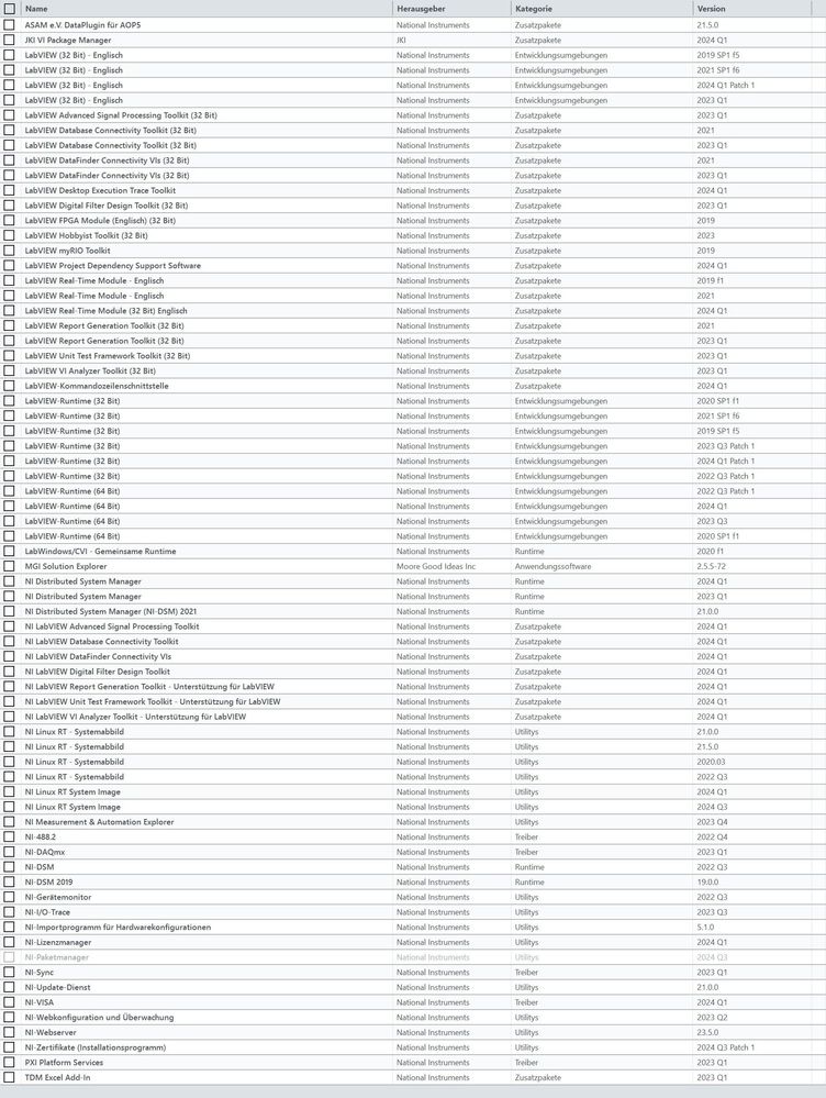

For now I can take my first steps but I can see how it is advisable to use a dedicated (virtual) machine for later RT projects. I do need 23Q3 32-bit for other projects but would like to clean up my system. It would be great if you can link me to the safe way to do this. Here are the screenshots of my installed Software:
MAX shows FPGA and Real-Time support when you expand the explorer entry:
Here's the Screenshot of the Package Manager:

Hello, Viktor.
The listing from NIPM looks "mostly complete".  The only obvious absence was "LabVIEW FPGA Compilation Tool for Vivado, 2019.1" which you would need to compile your own LabVIEW FPGA code for the myRIO.
I found that installing the myRIO Toolkit for 2021 very tricky (I had to get help from the Developers, who told me the "trick" that I was not following).  At the present time, I'm sticking with the 2019 version of the Toolkit, and hoping that NI keeps supporting it for a few more years.  I strongly suspect that the 2021 version of the Toolkit will be the last one to be released, as NI has announced it will stop selling the myRIO in 2025.
