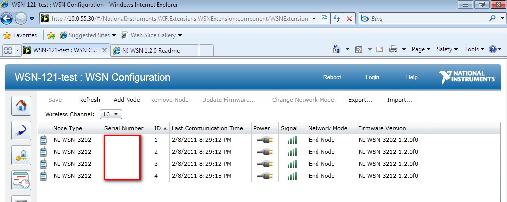

If you have not already done so I would make sure that you are using NI-WSN 1.2 which is the latest version that includes web based configuration for the NI 9792. Go to ni.com/support to get the latest driver versions. The great thing about the 9792 is it has an embeded web service, similar to any standard wireless router, that will allow you to configure your device via a web browser. If you point your web browser to the IP address of your gateway, are you able to see the node configuration page? You can also use the NI Network Broswer to find your gateway if needed. See my gateway below:

The great thing about the 9792 is it has an embedded web service, similar to any standard wireless router, that will allow you to configure your device via a web browser. If you point your web browser to the IP address of your gateway, are you able to see the node configuration page?
Yes. I can see the gateway page, but no reference to node page.

The fact that you cannot see your node configuration page in both MAX and your web browser, leads me to believe that all the software may not be installed on your 9792. Will you look at the pictures attached to this post and make sure that you have the same software packages installed? What software do you have installed on your 9792?

First, I performed an installation of WSN 1.2 driver again. After rebooting my computer, I realized that my gateway don't have those softwares presented on the pictures you sent me installed. After transferring these softwares to the gateway, I could find the icon "WSN" in the configuration tree in MAX.
