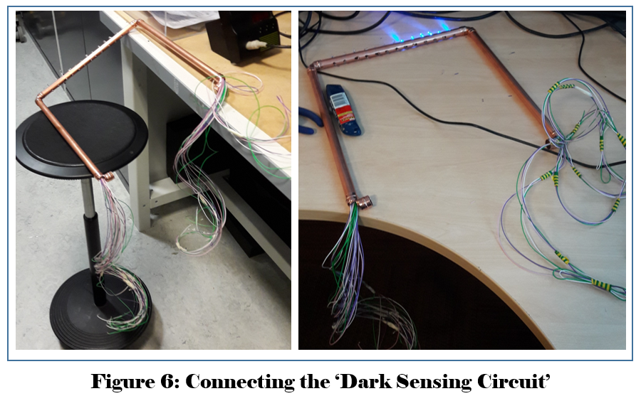

Figure 6 shows myLaserHarp being built. The wires to connect the LEDs and the LDRs were fed through the copper pipes. On reflection, copper pipe was not a good idea for the since it is essentially an short circuit waiting to happen (and this occurred more than once):
