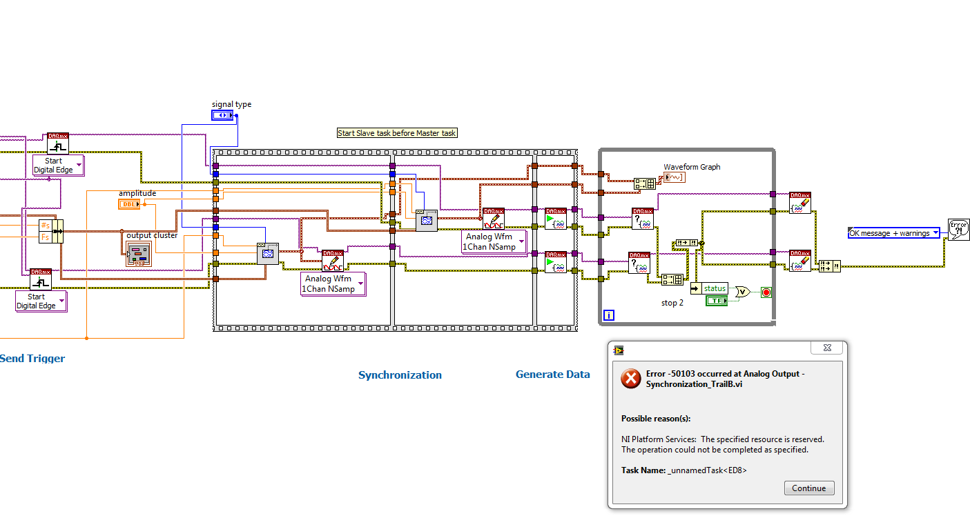

So I made some changes in my requirement and now I am stuck in a different problem. At this moment I am trying to generate two analog outputs from two different channels synchronously using an external digital trigger using PFI line. My individual VI work fine but synchronization is not working.
At the moment I am getting error 50103. I looked at Labview help for error 50103 (http://digital.ni.com/public.nsf/allkb/485201B647950BF886257537006CEB89) and made possible changes but I am not able to resolve the problem. I have attached image of my VI. Could you please advise me where I am making error and possible solution for this problem?

Hello pjkunwor1
You might be using the same resource in both tasks. If you attach the VI we could assist you, however you should create a new thread since now the issue is different and we should keep order with our discussion forums.

You should search for that error. You have to place both channels in a single task. That means a single DAQmx Write set for nchan.
