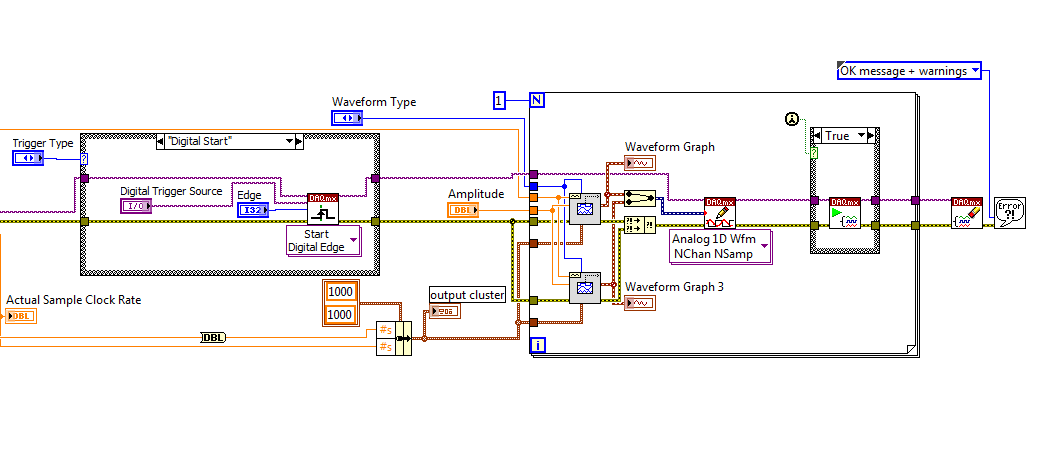

I am trying to generate two analog signals from two different channels of my USB X series 6353. I am using an external digital trigger form one of the PFI0 to trigger the outputs. At the moment I am continuously encountering error 50013 (specified resource is reserved). I looked in NI help for the issue and made suggested changes but problem still exists.
I have attached my VI for further investigation.
NOTE: While running individually, the analog output works fine.

Did you remove the second task? Did you write both waveforms to a single DAQmx Write? As the other threads regarding the error message state, you have s single D/A on the device.

Hi Dennis,
So are you suggesting I need only a single line of code?? Delete slave channel and all its properties?? No need to synchronization?? I am beginner to LabVIEW and not really understanding what you are suggesting.
I started out with single channel analog output and it was working fine. Since I am aiming for final results with 4 outputs I was directed towards synchronization of channels, hence I started with two channels.
The final result I am working for
AO Channel 1: DAT
AO Channel 2: -----50us wait-----DATA
AO Channel 3: ---------------100us wait---------------DATA
AO Channel 4: --------------------------150us wait-------------------------DATA
Where DATA is my analog output of a single sinusoidal signal.
At this moment I am confused on how I would be able to generate my final results with using single task. Please advise me if am going in wrong direction.

You have a single d/a clock and you don't have any choice except to use a single task. That is the whole meaning of the resource reserved error.
I'm not totally familiar with all of the x series options. You may have to pad the different waveforms with values to achieve the delay. Say you have a 1us sample rate. You've got a sine wave that you need to output on both channels with a 10us delay on the second. Prepending 10 samples to the second waveform would give the delay. You probably would need to make the waveforms for each channel the same size.

Hello Dennis,
Thank you for your reply. I deleted second task and added second channel to the same task. And it’s working for now. I am getting same signal at the same time from both channels. Thank you for your help.
But my bigger problem is How to add a delay of 100us between outputs from first channel to second channel?
Is there a way I can output zero’s after first channel output for 100us and then a single sine output??
