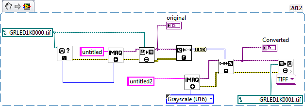

I think there is something wrong with your tiff file. Because when I save it with LabVIEW in U16, I can reopen it perfectly (see attached file). What program did you use to save it?
(If you use IMAQdx to grab your images, I know there is a pixel signedeness that can affect this. See advanced attributes of your camera under MAX.)
Message 4 of 12
(8,407 Views)
Sometimes its happened with 16 bit tiff files. The problem with "negative" part of 16 bit range. This also could be Vision issue.
Anyway the given file can be easily opened with the following snippet:
Andrey.

In fact, I used exactly the same code as Andrey, and simply saved the U16 image obtained with the IMAQ Write File function (in TIF mode).I16toU16.png

Hmm... I think nothing wrong with my code. And nothing wrong with your image. The problem is - how NI recognized that the image should be interpreted as I16 or U16.

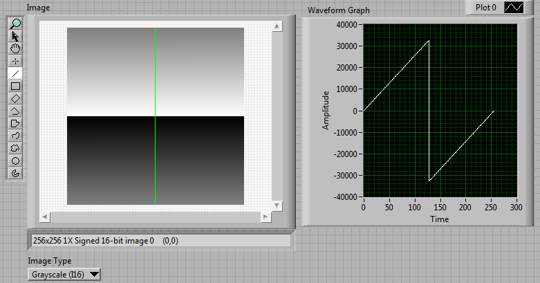

Lets me explain. At the first we will create two images with NI software - one is I16 and another one U16.
I will use pretty simple code for generation gradients with full 16 bit range, then save both to 16 bit files and read these files back:
Result of this code is:
So far so good. I16 saved and loaded as I16 and U16 also properly loaded.
Both images can be loaded into ImageJ. Take a note - both interpreted as U16, but appear properly:
then I will save this image as IJ-U16.tif
Now I will try to open this image in NI software with the following snippet:
Result (I added vertical line profile for better understanding what's going wrong):
As you can see - after saving in ImageJ the image wrong interpreted as I16 instead of U16 and converted in bad way.
