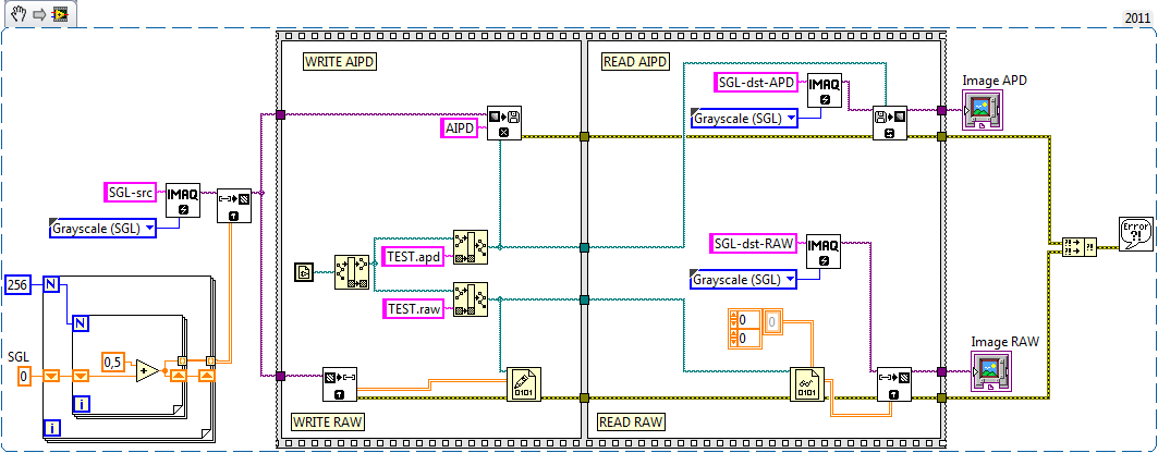

The easiest way for you to use AIPD format (which in the fact is RAW image with 512 byte header itself), or in pure RAW format.
For example, you can write and then read SGL images in LabVIEW in following ways:

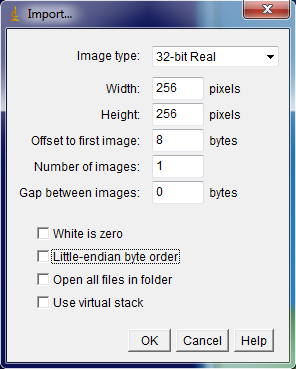

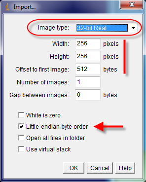

Now you can open these images in ImageJ by choosing File->Import->from RAW...:
For AIPD you have to set then:
For RAW binary file:
Little Endian byte order and header offset depends from options which was used for Write to Binary File primitive.
