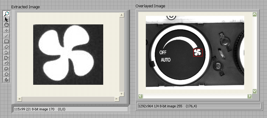

ROI from Pattern matching

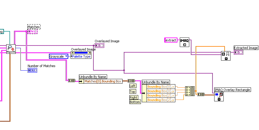

Pattern matching unlike any other programming language is readily and easily available. The struggle comes when we want to extract the matched part or overlay the part.
18017iF783D37CA7672D1C
The pattern matching has an output indicator called matches which is an array of clusters and we have to convert that into a cluster to get the required bounding box. This is explained below
18019i49497BD410D9567A
The template matched can be extracted as well by using an Imaq extract as shown above.
18027i79F4152888D25F71
