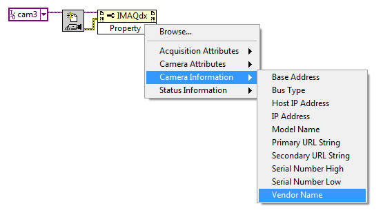

Hi, Andrey!
I have installed LabVIEW 2010 and the NI-IMAQdx functions are just the same as the picture shown above.
Now, I have a problem. In old LabVIEW/Vision versions, I can use the IMAQ USB propertypage.vi to access the properties page that is provided by the camera manufactuter, how can do this with the functions in IMAQdx?
Message 7 of 10
(7,591 Views)
you have to use the IMAQdx property node, you will be able to find a lot of informations.
Message 8 of 10
(7,579 Views)
Hi~
Could you show me how, please?
Message 9 of 10
(7,569 Views)
Here you can find some informations about the camera and you are able to set attributes.
Message 10 of 10
