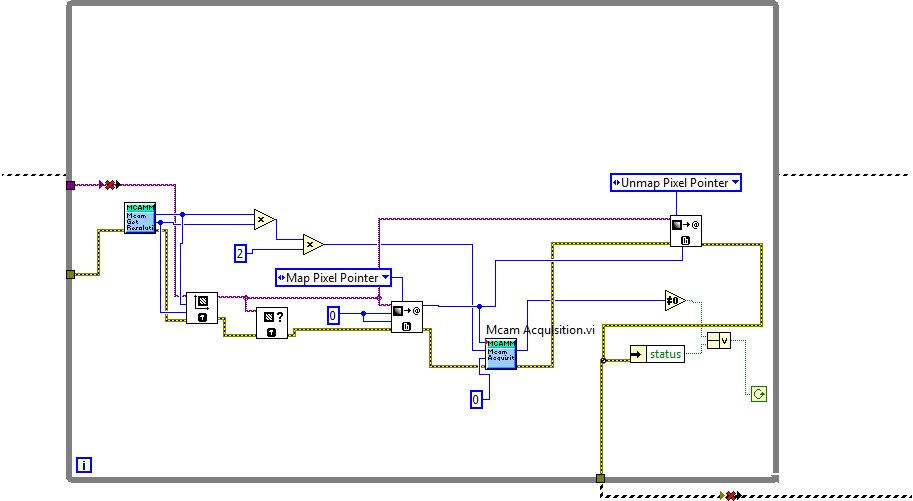

I have a program to acquire images from a Zeiss axiocam MR2 that has a PCI framegrabber.  Now I am trying to acquire images from one of their firewire cameras using the same program (while swapping the dll functions calls specific for the firewire camera) and it crashes every time I try to acquire an image, even while debugging in steps.  Is there something intrinsically different with the firewire camera that I need to do differently?  I create a 10 frame buffer with IMAQ create, set a ROI in the firewire camera (works no problem), create a pointer to the buffer, and then put the image into the buffer.  No problems with the camera containing a framegrabber but the firewire camera crashes every time on acquisiton.  Any ideas?  Thanks

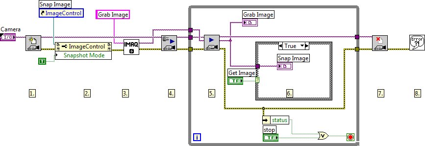

Ok.  I can see that a firewire camera that doesn't conform to the DCAM spec won't work with the IMAQdx driver so I can't take that approach.
What I still am not understanding is why I can't create a buffer using IMAQ create that I can then place images into using the acquisition function supplied by Zeiss.  It seems in the example below that in the case where IMAQdx is used to store images in a buffer using IMAQ create.

Well, it is finally working using the code from the bottom of my last post. It had been crashing because I was passing the pointer to the array to the library function when I needed to be passing the value.
I did get confirmation that the camera doesn't conform to the DCAM spec so taking the conventional route with MAX would have been hopeless.

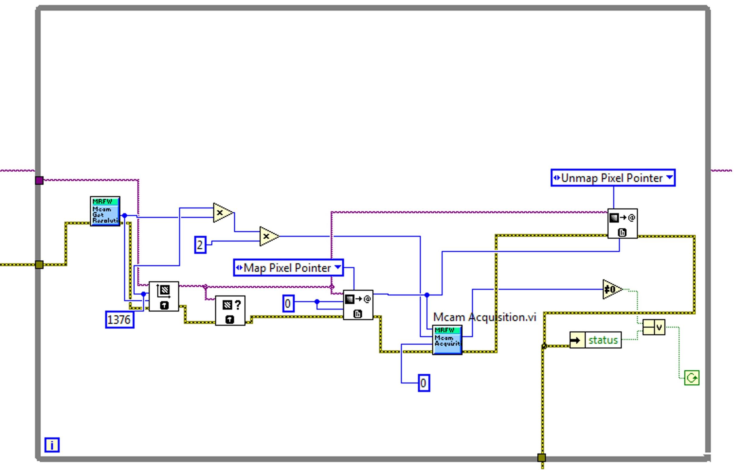

An edit to the image I posted:
1376 is the width I had set for the ROI instead of 1388 and are values for the buffer size.
