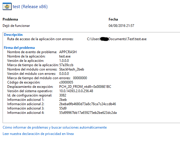

CVI executables causes Access Violation 0xC0000005 on Windows 10 Anniversary Update.
Created executables always causes Access Violation (exception 0xc0000005) at close time on Windows 10 RS1 (Anniversary Update).
The issue occurs in both LabWindows CVI 2015 and 2015 SP1.
How to reproduce: create simple program and compile with default Release (x86) profile.
e.g:

The problem is visible on Control Panel > Reliability History > Error Reporting:
Also return code of executable (exit code) is always 0xc0000005 instead of zero.

I have observed that if multiple instances of the same program are running, only crashes when the last instance is closed. It seems that the problem occurs at the time that CVI runtime is released from ram. (The latter is only an assumption)

Accepted by topic author jogal
We did some investigation and saw that the failure is related to some font files located in
c:\Windows\SysWOW64\cvirte\fonts
c:\Windows\System32\cvirte\fonts
Could you try remove these files and see if the crahs still occurs. If not, this would be a workaround if you don't use these fonts.
We keep investigating to see the exact cause
