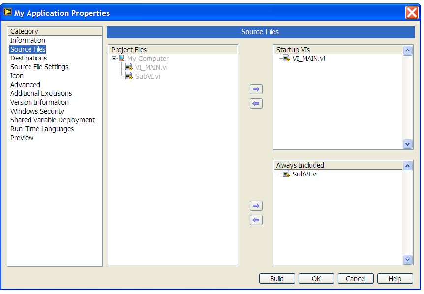

Don't forget, in the "build specifications" of the application (EXE), to "always included" all the the subvis you open by reference.

Will do....thanks.
Humming along now.
