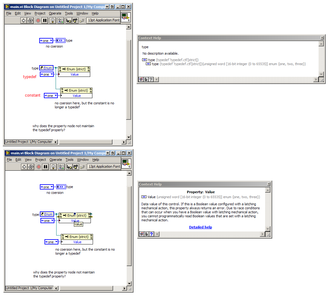

Can someone explain to me why a value property node created from a reference from an enum does not retain the enum typdef.
To illustrate:
1) create a new typedef, save this as a control (stricy typedef)
2) drop this typedef into a VI as an indicator
3) right click on it, choose create constant, this works as expected, no coersion dots appear
4) right click on the indicator, create a reference
5) right click on the reference, change it to a control
6) from this control create a writable value property node
7) wire the original constant created in step 3 into the value, now coersion dots appear.
Why does creating a reference lose the association with the typedef? (If you create a constant from the value property node it is not a typdef)
Attached is a simple VI to show this

If you get the 'one' typdef in context help, we can see that it is defined as a typedef, when we get the context help for the property node, we can see that it is not defined as a typedef.
The reason there is the coersion dot is that the two data types do not match, with the constant both data types are I16, U16 so there is no coersion dot

I've been playing with it for the last half hour, but can't make the coersion dot go away. As you say, the property node doesn't seem to carry on the typedef. I think it's because you can't explicitly define a property node as a typedef.
Directly wiring and local variables = no dot
referencing = coersion dot
