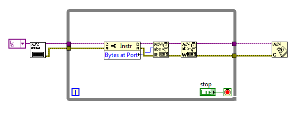

I think I got your point. using a serial port configure function it's showing RIO0 in the dropdown list and so that refers to sbRIO-9631 right? So in the place of computer I have the robot now. If I want to read some information from the robot say the LED status then I open a FPGA reference from FPGA interface palette. What bitfile should I be using for communicating? is it of if I use the starterkit roaming bit file that comes along with sbRIO-9631? Or should I develop a bitfile of my own. If I should develop a bit file on my own what information should that contain?

It sounds like you got the idea for using the integrated serial port on the sbRIO.  The VI would look something like the following and run in RT on the sbRIO (except the constant in to the configure serial port would not be blank).

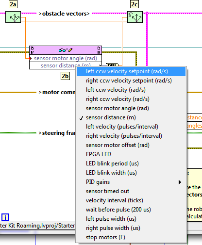

To your second question, yes, you can use the bit file that comes with the roaming example.  In fact, if you start with the Starter Kit Roaming.lvproj (the example), the main roaming VI is a good starting point for writing your code.  The bit file it uses already has has code for the LED.  To access that information, use the FPGA "Read/Write Control" method, which is found on the FPGA palette.  It is also the same block used in the roaming example in a few places (as shown below).
