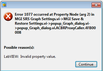

I do not really have experience with dynamic VI calls, so I would like to ask for some help.
Here is a (screenshot only) part of my MAIN VI, where I call a pop-up dialog VI using the "dynamic call and forget" method:
I only pass one reference into this VI, the ref of the pop-up button, so when the user closes the pop-up window, I re-enable this button on the MAIN front panel. This pop-up dialog functions as a Graph monitor, it can update its Graph using an ActionEngine which is a buffer. So please ignore the missing type defs and the ActionEngines, they are not relevant in this case. Find this pop-up dialog attached.
Actually my application just works, I only started to get some problems since when I included the "MGI Save & Restore Settings.vi" in this pop-up dialog, in order to save Graph settings to a config file (the application will be used as a built exe). When I close the pop-up VI, I can see the Graph settings are properly saved into the *.ini file under the "Documents" folder. However, when this file exists already, and I call this pop-up VI, I get the following error (so when the MGI VI is fired with the "Restore" action at the beginning of my dialog VI):
I have three questions:
  1. What I do is it OK? I mean to pop-up such dialog, is it OK to use the "call and forget" method?
  2. When the user closes the panel of the pop-up VI, does it stay in the memory? Do I have a memory leak, or it closes properly? (I think not...)
  3. I do not understand the error produced by the MGI Toolkit VI, it has something to do with the dynamic call method? I even feed it with the static VI reference of the pop-up VI itself. Before I tried the "This VI" reference constant, but getting same error.

I have managed to pinpoint the location of the error, see the attached VI. The MGI toolkit creates an error, if I have a cursor on this XYGraph. "Invalid property value: cursor list."  It is strange enough, even if the config ini file does already exists, you need to run TWICE the VI in order to get the error. So every second run does not create error, however neither functions properly, does not reset settings of the graph... 🙂
If you delete the cursor, no more error, all works fine.
I will try to investigate this further, but if someone will be faster, thanks! 🙂
edit: a funny workaround could be to save time: before Reset/Save settings using MGI kit, I programmatically delete the cursor, and after re-create it :))

Just FYI, I have mailed the MGI people, and they found the problem very quick 🙂
Here is their reply:
" I've looked at the root cause for what you're seeing and uncovered a LabVIEW bug that I'll be reporting. Apparently LabVIEW is giving us a cursor xscale property of 65536, but that is an illegal value. We get the error when we give that value back. I've attached the VI that I'll be sending in to NI to describe the error.
I've also attached a replacement subVI that works around the issue. We'll release an update later after proper testing, but this works to fix the sample code you sent."
