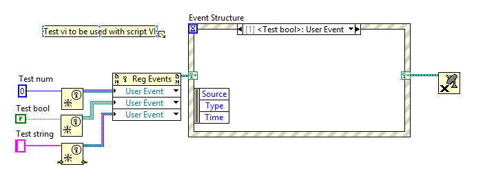

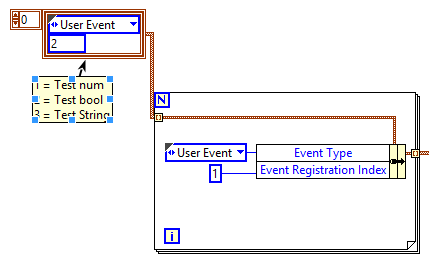

Hey there,
Saw this post and thouht it would help. I am having some issues with scripting the event cases. I see in this example using the "StaticControlEvents", I can get this working just fine, but what I am trying to do is use the "DynamicEvents" to populate my event structure with the dynamic user events.
I have used the code above as a base. What I have achieved so far and found. If I have an event strucute with three seperate events register Bool, num, string I can add one of these the event sructure. How ever if I try to add another I get error 1. Where am I going wrong?
Where
Attached is my scripting.
Any help is welcome, I am new to VI scripting so trying to learn as much as I can. Sorry to hijack this post.
