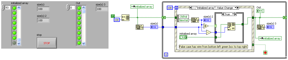

I am using LV 2009 SP1 and would like to create a 1D array control of fixed size.  The array elements are a type-defined cluster of varying data type controls (enum and boolean).  The array control will reside on a front panel and will be intialized with values via software, yet the user will have access to modify the array element values (i.e., modify the enum and boolean controls.  While the user has access to modify the array elements, I do not want the user to be able to add new elements to the array.  The array needs to have a vertical scroll bar since the number of elements when the array is initialized may be large and also may vary.  I am familiar with the "Number of rows" array property but this only controls the number of visible rows in the array.
Is there a way to fix the number of elements programmatically and still have a scroll bar for the user to index through the array, but not add new elements?
Please also see the attached screenshot for reference.

The following code (in LV2010) employs an event structure to capture when the array value is changed.  If the new array size does not match the old array size, the newly added element is deleted.  This keeps the array size the same as the original.  But any of the existing elements can be changed.  The code has local variables and size indicators throughout to show that the size of the array cannot be altered.  Use the parts of the code as you need.

Sorry tbob, but this is kind of a messy way to deal with the issue.  Why even allow the user to try to add new elements if you are just going to delete them?
I only want to display a fixed number of elements and no more.  The UI should not seem to provide functionality that doesn't really exist.

Yes its messy.  But do you know of another way to do it.  You cannot disable the array control because you want users to be able to change the elements.  There is no way to allow them to change, yet not allow them to add.

The only way I know of to add or delete elements from an array control is by way of the shortcut menu.  Do you need the right click menu for the array?
If not, use an event structure for the array for Shortcut Menu Activation? and wire a True to the discard terminal.

I found an acceptable solution through reading some other forum posts.
For others who may find this useful:
By hiding the array index display and all scrollbars, the array can be fixed in size.  A separate scrollbar control is used to index through the array by writing to the Index Values array property.  The scrollbar min/max can be limited by writing to the Doc Min, Doc Max properties.  I have attached a screenshot of the block diagram.  The constant value labeled "# rows visible-1" is set to the # of elements visble on the front panle minus 1, and keeps the array control from displayiong empty elements that would allow the user to edit.  Also, although the Page Size property is set to zero for the scorllbar, which should allow scrolling from Doc Min to Doc Max,  it does not accept this as a valid value, and instead is coerced to a value of 1.  I have submitted a SR on this as it may be a bug since the LV Help suggest that zero/negative values should be acceptable for the Page Size property.
