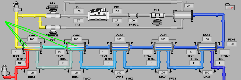

I am changing the "State" cluster in the init code. Not setting the boolean anywhere except the "Panel re-size" event of teh Facade. I would not think the pnael re-size event is firing unless I am re-sizing the control.

I was hesitant to post the XControl but I am only limiting the community's ability to help and learn.
Here is the project in LV 8.2.1.
This XControl is intended to be a color ramp that can be used to illustrate gradiants in a system. I am using it to illustrate the temp change across heaters and heat exchangers.
Please keep in mind that this is my first attempt at developing an XControl from scratch. I also do not concider this a finished XControl since I have not added mtethods to define the color ramp yet.
If you have any ideas, fire away!
Otherwise I hope it helps someone!
Ben

Meghan wrote "I could not get the save dialog to display upon opening. "
No, not a save dialog on open.
When you open the VI there is an asterisk next to the name in the title bar.
Are you telling me you did not get the asterisk?
I just had another engineer try it on his machine and he got the asterisk.
Even after he saved it and closed it, on re-open he got the asterisk.
Ben

See image for the asterisk.
Ben
