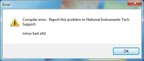

Nope, repairing the Labview and Unit Test Framework installations didn't help.  But in other exciting news I'm now getting this error...
Related?  I dunno.  I started seeing this error yesterday while working on a class probe.  Today it's progressed to the point where this error appears in an endless loop when I try to open my project.  LV didn't generate an error log.
Message 3 of 20
(5,689 Views)
Update:  I believe the last error is a different issue.  I was able to narrow the error down to a specific library and generate some error logs.  That library hasn't had any code changes in over a month.  The error logs point to something in the f2 patch, which I installed last Thursday.  Unfortunately there doesn't appear to be any way to uninstall the patch.

Thanks for the logs. We'll see if we need the code. But let's first focus on the UTF crash. I am assuming that it still occurs with even a new project, where this Compiler Error only shows itself when you use that specific library in the project?
Yep, the test vector bug still occurs even with a new project, just saved, with nothing else added.
(As an aside, I reinstalled LV without the f2 patch and the complier bug is still occurring.  But I'll start a new thread when I have more information about that problem.)
