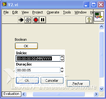

I have a problem with the function Convert Panel to Screen Coordinates. If a VI is inside a SubPanel, this function return wrong Coordinates. Otherwise this function works properly.
The attachments explains the error.

Olá,
No meu caso os resultados não são os mesmos.
O objetivo deste código é exibir VI3 sempre na mesma posição, logo abaixo do botão. Isso acontece quando pressiono o
botão Menu e da mesma forma era para acontecer  quando pressionasse OK em VI2, que está inserida no subpanel.
Vamos lá, se eu rodo VI2 fora do subpanel VI3 aparece na posição correta, logo abaixo do botão. Agora, se VI2 está no subpanel a janela de VI3 aparece numa posição que não seria a esperada.
Bruno.

I dont have any problem to show or hide this VI. My problem is wich that VI3 shows in wrong position of the screen when i call VI3 with VI2 and this not happen when i call VI3 with VI1 or VI2 is not inserted in VI1.
 VI3 Called by VI1
 VI3 called by VI1
 VI3 called by VI2 inserted in VI1
 VI3 called by VI2 not inserted in VI1
I hope explain this problem correctly.
Bruno

Hi Bruno,
I did a test using a different approach and it looks likes ok for me, try to substitute your V2.vi by the attached file.

HI,
Great, you give to me a workaround.
But, the other way would also be correct?
Bruno
Message 7 of 8
(5,009 Views)
Hi Bruno,
 To be true I think that there are different behaviour to the method CvtPanelToScreenCoords when using it inside a subpanel, I didn´t understand what and way, so I decided to use the workarrond proposed. But I didn't find  any thing about use this method inside a subpanel.
