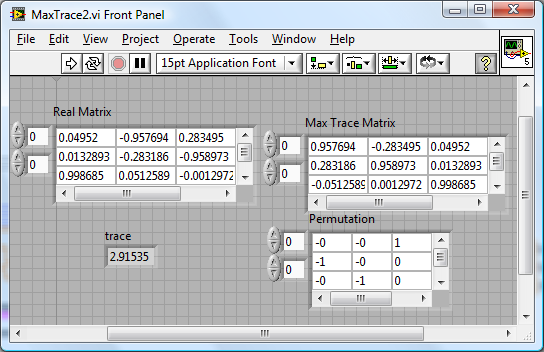

Permute matrix columns to find the matrix with biggest trace
I am trying to make a Labview Vi that picks any 3x3 matrix and permutes the columns (not rows!) until it gets the ordenation that has a greatest trace (sum of diagonal elements). The program should also allow a sign change of the elements of one or more columns. If I am not wrong for a given 3x3 matrix and considering the column sign change there are 36 possible matrices, and the program should automatically show the one with greatest trace

Here's my version. It can easily be adapted to work with any size (within reason!) square matrix.
Since columns can be optionally negated, we can use the absolute value for the trace calculation so there are only 6 permutations to test in the case of a 3x3 array.
(I have a subVI that can generate a 2D array of all index permutations given N. We can replace the diagram constant with it and my VI will then work for random sized square input arrays.
See if this makes sense. 😉

Sorry, I pasted the wrong permutation matrix diagram constant for some reason. As you can see, it has only two unique permutations instead of six. Silly! You can easily paste Darin's permutation matrix and it will work correctly. 😉
Here's a more general version that generates all permutations on the fly (LV 8.5). It does a 10x10 in under two seconds (3628800 permutations!).
See if this works better for you. 🙂

If moving beyond a fixed 3x3 matrix is the name of the game, hardwired constants and permutations are certainly not the way to go.  During some "private time" this afternoon I figured that I could tweak the classic assignment problem to solve this problem.  I had to do a quick conversion from my Scheme code (think Lisp) to LV, but it seems to work like a charm.  I use the well-known Munkres algorithm to find the solution for an arbitrary NxN matrix.  Since sign changes are allowed, I work with the absolute value of the matrix and at the end back out which columns are inverted based on their final position.  Since the Munkres algorithm is a cost minimazation technique, I negate the matrix so I get back the maximum.
Probably a few tweaks to improve memory management, etc., and maybe a bug or two but this is some quick and dirty code.  It will do a 200x200 matrix in about 2 seconds on my machine.  If I had a few trillion years on my hands I'd double check with the brute force method.
