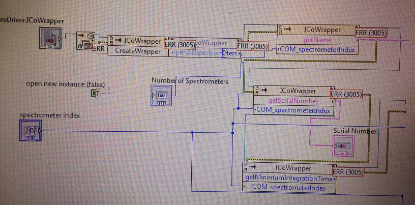

Hi, All
Im a graduate student and i just inherited Labview VI to acquire data from an oceanoptics HR4000CG-UV-NIR spectrometer. When i run the vi i get a 3005 error at the IcoWrapper, vi potion below. This VI has no problem on an XP computer, but since im trying to upgrade to Win7 64bit i have to fix the issue and i would like to ask for help.
Labview version: 13.0 32bit
Win7 64bit
OmniDriver+Spam 32bit
Thank you for your time
LennyS
(13,274 Views)
Hi Lenny,
no problem. This is a generic issue when trying to execute 32-bit software with hardware access on 64-bit OS Windows environments. The issue is a buffer underflow in the driver kernel as Windows expects a 64-bit answer. It does not realize that the driver will only answer in 32/bit accuracy. there are 2 options to work around this. The simplest one would be to uninstall OmniDriver and then reinstall it under the 32--bit compatibility mode, so that windows is told that this is 32-bit. This is quite easy to do. Please right click on the installer exe file and go to Properties. Then select the Connectivity tab and use the "WinXP SP3 compatibility" option which is by default 32-bit.
Then the Omnidriver package will install, you can verify the correct driver registration via the spectrumtest32.exe from the OOI_HOME subdirectory of the Omni+SPAM installation folder. Please run that test with a spectrometer connected to the PC. Please also mind, that the first time you connect the spectrometer Windows Update will look for the drivers. You can either wait a couple of minutes for WinUpdate to complete checking the database or cancel that part and tell Windows to look for the driver in the Omni+SPAM installation folder + subdirectories.
Please let me know if this solves your problem.
Best Regards, Oliver

Hi Oliver,
Thank you for taking the time to reply to my post.
I managed to follow all your steps and got the spectrometer to work with spectrasuite and other software. After running my VI however, i got an "Error 91 occured at variant to data in spectrometer interface.vi". Is there a way to correct this error without rewriting the VI?
Again, Thank you for your time.
Lenny
(13,199 Views)
Hi Lenny,
thanks for the post and i am glad that you got all things working. the variant to data call is a tricky thing. If possible try to work with fixed variable types. this usually prevents getting in trouble with the variant class.
I have done a quick search and there is quite a large number of fixes on the variant to data call also here on Sine. They seem to be linked to different variable types in the source and the sink of the call.
