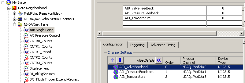

Create a DAQmx task that samples multiple channels.
You did not post your error message, but it could be from multiple VIs trying to communicate with the module simultaneously.  You can't do that.
