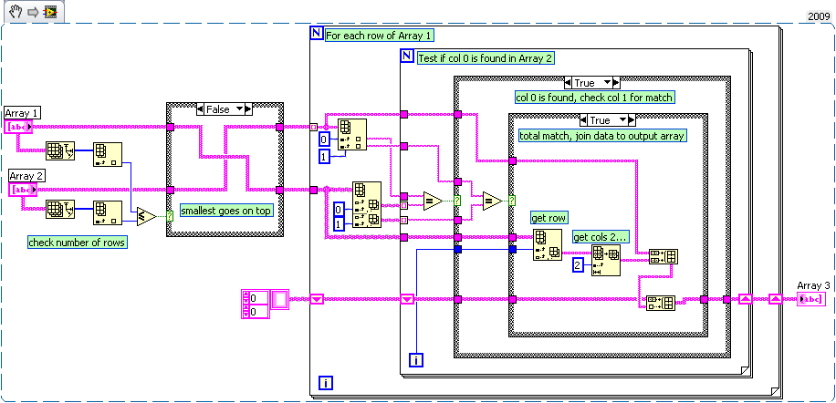

Here is my solution, it's like tbob says just that I'm searching rather than assume that the arrays are ordered and with the same indexes.
Rodrigo Cuenca

Rodrigo beat me to it.  Here is my code.  It does the same thing.  I didn't use search because it will find the first instance and then stop, and you have to account for that by continuing the search.  So I used auto indexing to look for a match with each element.

Using a small data set all of three versions of the code worked even when the data was out of order or did not have the same number of records.  For the various versions of the code I was able to swap the inputs and the code still worked except for MatchEntries.vi.  I modified the code to obtain the two arrays from a file, one file had 159,226 records “ARRAY1” and the other file had 40,357 records “ARRAY2”, hence why I was not going perform the routine manually in Excel or by writing it down by hand.  Since the files were so large none of the three versions was able to process the data on my computer “Memory Full”.  Using a smaller data set, 38,700 records for ARRAY1 and 9,616 records for ARRAY2, which is all I really needed I was able to process the data correctly with two versions of the code.  For comparison purposes, I processed the same data set three times with each version of the code. The code “Array Match.vi” written by tBob took an average of 132 seconds to process the files and the code “MatchArrays.vi” written by DarinK took an average of 115 seconds to process the files.  I decided to use DarinK’s code.  Sorry to say the code “MatchEntries.vi” written by Rodrigo could not process the data set.  I allowed the code to run for five minutes and ARRAY3 still did not have an output.  Since the code worked on a small data set when the inputs was swapped, I went ahead and swapped the inputs for this larger data set. Even once I swapped the inputs the code still did not process the data after five minutes.
