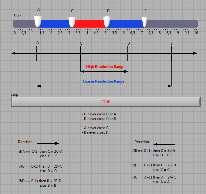

Hallo,
This thread might be already dead but I need a similar help:
Do to my task I need a scaling possibility that allowed me to set :
- a Coarse Resolution Range A to B
- and within A-B a High Resolution range C to D
Those ranges are very dynamic… therefore I’m building a GUI that will be used by the Field-Operator for adjustment…
Here in attaché my considerations with a slide control (4 Slider) but it’s not working….
I’m thankful for anyone who can lead me to the right direction Smiley Frustrated.

Hi Serikah,
at first some basic math:
   IF (A == C-1) THEN C = 2C-A ELSE C = C
can be transformed to
   IF (A == C-1) THEN C = 2C-A = 2C-(C-1) = C+1 ELSE C=C
The other operations are similar...
Next problems:
- Using two property nodes in parallel to set values of a control will lead to race conditions!
- Constantly setting the value of a control will give a very bad user experience...
- Comparing floats for equality will lead to numeric accuracy problems, as has been pointed out a lot of times before in this forum! You better compare with ">=" (or "<=") instead of "=="...
- Instead of polling the slider you should use an event structure waiting for a ValueChange event...
- Is the user allowed to move A&B too or does he only move C&D?
- Use Min/Max function to limit movement of inner sliders...
- Use InRange function to detect "coarse" range(s)...

Thank you GerdW
for the quick response and the correction.
To your question: “Is the user allowed to move A&B too or does he only move C&D?”
YES. He is going to set all 4 Slider.
I just need to make sure he never set A>C and/or B<D
My first option was with “inRange Function” as you suggest in combination with property nodes.
Bus this only works by a slide-bar containing only 2 Slider.
The property nodes “Data entry Limit” and “Scale range Limit” set the limit for the whole Slide-bar and not a Limit within a Limit.
SeFe

Hi Serikah,
My first option was with “inRange Function” as you suggest in combination with property nodes. Bus this only works by a slide-bar containing only 2 Slider.
Why should InRangeAndCoerce only work for a slidebar with two sliders?
You can get the current value of all 4 sliders and compare each pair of them as needed!
