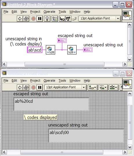

It seems like the unescape method always adds an extra \00 (%00) at the end of the string.

You can open up the Unescape function as a subVI.  I copied the code to a regular VI so I can do highlight execution.  It searches the string for a % character, and converts the next two characters after that to the ASCII character.  Well, when it doesn't find a % character, the Scan from String function raises an error (which the execution mode of the original subVI ignores because Enable Automatic Error Handling is unchecked).  So what happens is there is no final %2x to find, the error is ignored, and the default value of the datatype is returned (a zero), and that is converted to the ASCII 0 character which is a null and appended to the end of the string.
Now maybe it is intended behavior to return a null terminated string.  But it isn't the cleanest bit of code to take what is essentially an error in the Scan from String function, ignore it, and allow the default behavior to put a \00 at the end of the string.

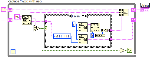

I agree that it is likely a bug.  BTW, you can change the VI's execution properties to allow execution highlighting ("Allow debugging").
There's a similar (though not identically coded) VI distributed with the NI Internet Toolkit called "CGI Unescape HTTP Param.vi" that I believe does a better job.  The case for no "%" character match is handled explicitly.  Here is the pertinent piece of that VI's diagram:
17823i3AA2181373F2E7E3
