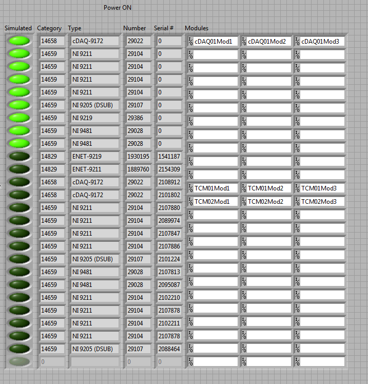

There are some property nodes (see VI snippet below) that allow you to see what devices are connected, and various information regarding each one
But all that info comes from MAX, or the config file for MAX or for NI-DAQ or somewhere; it doesn't come from the real world.  It doesn't tell me whether the thing is actually working or not.
For example, I ran that snippet and it showed me this:
There are my two ENET devices, plain as day.  I should mention that the whole DAQ power strip was powered OFF. So the ENET, cDAQ, SCXI, and PXI devices were all off line.
If I turn ON that power, and run it again, I get this:
(I have two real cDAQ chassis, named "TCMxx", in addition to one simulated one)
So it tells me that the cDAQ chassis is online, but that's not a problem for me, because the CONFIG process already tells me if it's not.
It doesn't change ANYTHING about the ENET entries, and that's my problem.

Steve,
I have confirmed that this is a known issue and has been reported to R&D with Corrective Action Request #295701.
Thanks for the feedback!
