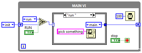

if you mean hitting the run time arrow  of the "main vi" then....
otherwise if it's a create state "run", then use a case statement in your "main vi". note: there are many different ways to do this Smiley Wink

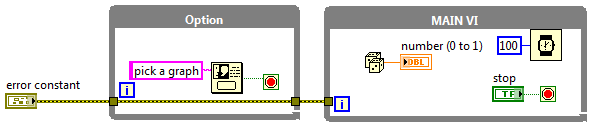

I am developing a program to run a stepper motor. The stepper motor is a part of a spectrometer that turn mirrors that should output wavelengths at different positions of the mirror. I want to develop a program in labview so that when I press the run button the vi it should give me two options. Option 1 is to take the mirror to home and option 2 is to start running normally. so it should pop up GO TO HOME or RUN NORMALLY. I should be able to choose either one.
That first WHILE loop is meaningless, because the loop always exits after exactly one iteration. Just wire the boolean output of the dialog to the second loop boundary and delete the first loop for the same functionality.
Codewise, that's just a state machine with three states. (1) Ask for mode, (2) Mode#1, (3) Mode#2.
Still seems incomplete. Does the program need to be stopped to switch to a different mode or can it be used continuously?
What if the user wants to RUN NORMALLY after GO TO HOME has completed?
