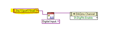

hi, i wish to use digital filter also, but my property node is having totally different items:
which property node you choose?
thank you

Hi Jackson,
Open a new VI. Place a "DAQmx Channel" property node: here you find all the properties you need.
For me it works to connect that property node to a DAQmx task reference:
Message 6 of 10
(3,800 Views)
would you mind to upload the VI that you showing in your print screen?
my labview is 2014 32 bit.
Thank you.
Message 7 of 10
(3,796 Views)
Hi Jackson,
I just placed that DAQmx property node, then I placed the DAQmxCreateVirtualChannel function…
(I didn't save that VI as it's so simple to recreate.)
Message 8 of 10
(3,790 Views)
Hi Jackson,
It is because you never connect anything to your "lines" input of the DAQmax create channel VI. Please note that in NI MAX you must be able to see the USB6525. Hope this help.
XJ
Message 9 of 10
(3,783 Views)
indeed!
now i got the digital filter settings,
thank you XJ
