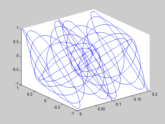

i used matlab to plot a 3d plot and change the length of scale, but i cannot find similar  method on labiew.
matlab test

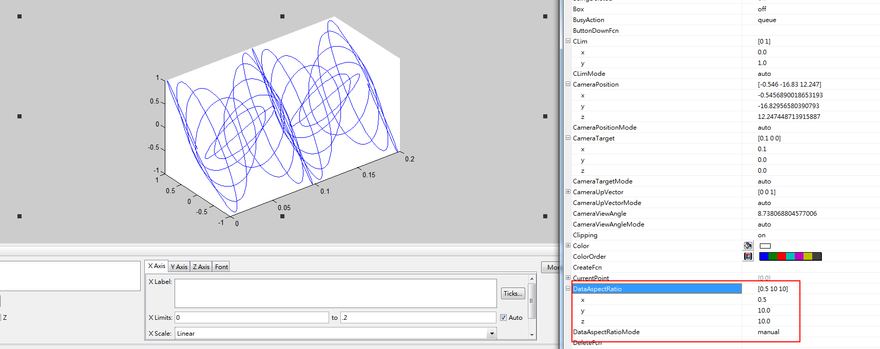

using DatAspectRatio to change grid length

The data aspect ratio of 3D graph in LabVIEW can be set through the "Axis" property node.
You can first specify the Axis -> Range -> Range Maximum (or Minimum) to set the limit of one axis, and then set the Axis -> Tick -> Tick Major Count to set the axis tick between limits.
