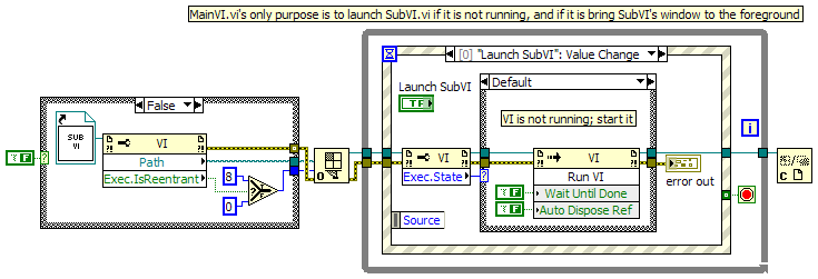

Okay, here's a copy of my current setup in general terms.  I tried to create Snippets with the Code Capture Tool, but since this is my first time using it I'm not sure if I succeeded.
MainVI:
SubVI:
In creating this example, I figured out that if I keep the reference open rather than creating it each time the "Launch SubVI" button is pushed, I solve the "keep functional globals in memory" issue I described in my first post.  I am still curious about how static VI references or static subVIs could be used in order to address the other two points, and appreciate any insights you have on that.
When you said use static subVIs, it occurred to me that I could run the SubVI in parallel with the MainVI at startup, and have some sort of dynamic control or signal to tell the SubVI to open its front panel and basically start executing the code, and maybe link the Close button on the SubVI to hiding the window instead of actually stopping the code... that just seems like a very convoluted solution, though.  😛
-Joe
Message 3 of 17
(6,907 Views)

Thank you, Rob, for illustrating where static VI references may be useful.  If I understand you correctly, they can only really be used for re-entrant VIs.
If I wanted to go this route for my situation, my understanding is that even though my subVI would be re-entrant, my FGVs would not.  Therefore everything would still work correctly (in terms of keeping variables in memory) as long as I only have one version of SubVI open at a time.  I'm not sure whether given this situation, I should choose "share clones" or "preallocate clone for each instance", or whether it doesn't matter since there will only ever be two total instances in memory (one for the static VI ref, and one that will be actually opened and run), and only one of them will ever be run.
In order to fully implement my setup, I also need to be able to bring the window of SubVI to the front if the button is pushed again while SubVI is open.  I think I could accomplish this by storing the returned reference to the clone that I open programmatically (setting auto-dispose reference to false), and checking that particular reference's execution state.
[pause to implement code]
Okay, I tried it, and got the code shown below.  However, this did not work for me - when I tried to launch SubVI, I got the "reserved for execution" instance that was not actually running (with the outlined grayed out Run arrow in the toolbar).  This despite the fact that probing the wires showed that the refnum I was opening was different than the static refnum, and no errors were occurring.  I set SubVI to re-entrant, and even tried both clone options (share or preallocate), and confirmed this by probing the property wire.  Any idea why it isn't working?
MainVI_StaticRef
Thanks again,
-Joe
Message 7 of 17
(6,857 Views)

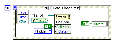

Hi Joe,
Perhaps we could attack this from a different angle. Would it work for your application to simply hide the subVI front panel when the user tries to close the window? Then you could just reopen the front panel when the user again launched the subVI. The image below shows how you would prevent the subVI from being closed. This would also keep this VI in memory.
Would this be an option for your application?
Tanya Visser
LabVIEW Group Manager
Message 10 of 17
