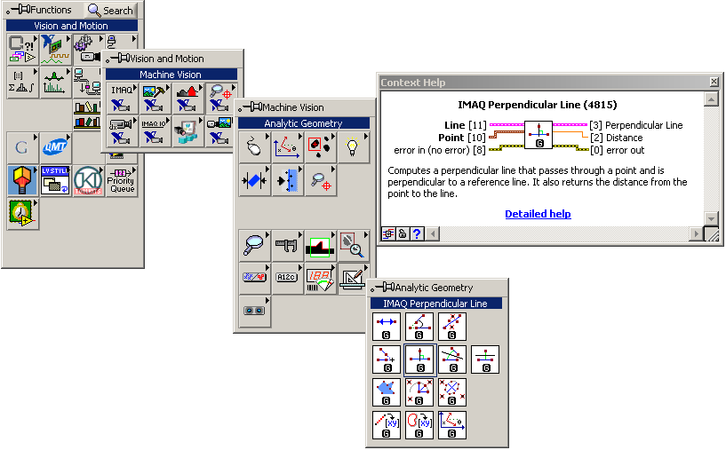

I want generate a perpendicular line to edge, which was found in a ROI.
Please see the attachement. The green line is the edge and the black line (manually entered with paint software) should be the perpendicular line and in the middle of the green line.
The problem is: the green line isn't horizontal.
Does someone have a idea or solution?

The IMAQ Perpendicular Line vi is probably what you need to use :

I have tied this VI. But without sucess.
I hope there is a other solution.
Please look to the attachment.
I have no idea, how can I find the important points.
I need the black linie.
Maybe You have a other idea?
Thanks in advance.

Hello!
I just tried the same function in LabVIEW 2012 and it worked as expected.
Maybe you can try the code below on your system? (I saved the VI for LV version 8.0 to make sure you can open it)
Which version of LabVIEW are you using?

Hello Georg,
the input: Point (SubVI IMAQ Perpendicular Line) should be determined automatically from the points of the red line.
Do you mean this is possible?
thanks in advance
greetings zäpfle
(4,335 Views)
 You implemented the function "Find Edges" already. This function has an output Array
called "Straight Edges" Within this Array there are all edges described by points.
By accessing the cluster within the array you can get the two points.
(see attached VI)
