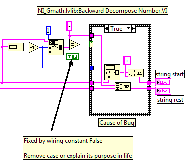

I have had great success recently using the SubVI setup 'Suspend When Called' which suspends execution when a SubVI is called, pops up its Front Panel and let's you manually enter the values you think it should have produced.  I decided to practice by trying to squash one of the more irritating bugs in vi.lib, the one described here.
Normally when you dumpster dive into about three layers of these formula parsing VIs your head is spinning.  This time I was undeterred and systematically worked through tracking down the problem.  Using the Suspend When Called I could see that when I gave the output I expected, the value was correct, so then I just had to track down the code that was making the change.  This greatly reduced the number of VIs to go poking into.
Finally, I got to NI_Gmath.lvlib:Backward Decompose Number.VI, I'll spare you the rest of this lovely VI and only show the cause of this bug:
The purpose of this VI is to split an expression into a number plus operator followed by another number.  For example 1-2 should split into 1- and 2.  For some reason, unbeknownst to me, they added that check at the end which changes 1- and 2 to 1+ and -2.  Simply removing wiring a false constant to the case fixes the bug, and also seems to handle the unary minus tests I quickly threw at it.
I am sure this predates all forms of Perforce logging so we may never know why this check is there.  Bottom line, Suspend When Called rocks, it cut through the vi.lib morass like a hot knife through butter.
