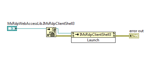

Thank you very much. I referred to this and managed to get this working. Now I am wondering whether I can embed the remote screen in my front panel. Please let me know if you have any  advise and I will post if I have any updates.
Thanks again.
