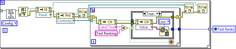

When sorting these results by the VI Time column, I saw that the VIAnUI Get Test Rankings.vi took way more time than anything else in the VI hierarchy.  I found this rather strange, given the simplicity of that VI's diagram:
This VI hasn't changed in a long time, yet I hadn't noticed the VI Analyzer launch slowdown until recent versions of the toolkit.  That's when I realized what the problem was.  As you can see, I am closing the reference to each test VI once I've retrieved its ranking.  Well, in LabVIEW 8.6, all the VI Analyzer Toolkit tests were added to a project library to support licensing of the toolkit.  And when you open a reference to a VI in a library, the library must be loaded into memory as well.  So in the code above, I am loading, then unloading the VI Analyzer Toolkit library on each iteration of the loop.  The fix was to simply build up the VI references on the loop output border, then wire the array of references to a single Close Reference function on the outside of the loop.  Once I did this and reran the benchmark VI, I got these results:
This subVI's performance increased 10x, and the overall execution time of the benchmark VI decreased from 7.5 seconds to 1.5 seconds.  The fix was extremely simple, but it would have been very difficult to track down without the help of the VI Profiler.

As I mention in the blog post, it is best to close references when you're done with them.  It tends to yield cleaner diagrams, and in the case of building up an array on a loop border, saves on the array memory allocation.  However, in the example shown in my initial post, I essentially implemented the simplest of caching schemes by building up the VI references on the loop border, thereby keeping the VI Analyzer tests library in memory and speeding up subsequent Open VI Reference calls after the first one.

If you're running LabVIEW 2009, you can replace VIAnUI Get Test Rankings.vi in [LabVIEW 2009]\vi.lib\addons\analyzer\_vianuishared.llb with the one I have attached here, and you'll get the fix.
