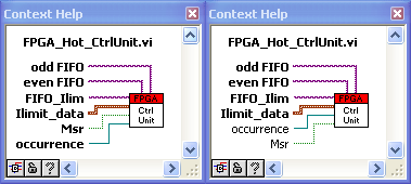

Hi Darren,
I actually think, I found a bug with this new feature:
I have my connector pane terminals defaulting to required and as soon as I switch them with the control key pressed, the connection property resets to recommended.
22136iBBFFF504A83F44DA
(notice that I changed "Msr" with "occurence") This behavior is observed on the standard (professional version of LV) and the FPGA module.
KR, stbe.
