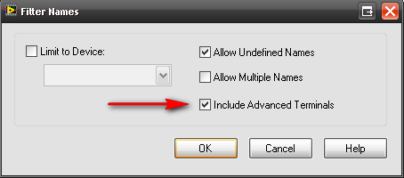

Like the error message states, we cannot trigger a counter output with an analog trigger.  We can however, set an analog trigger on an analog input task and then trigger off of the AnalogComparisonEvent terminal.  To do this, set up an analog inputor output task.  This will just be a dummy task.  Set up your trigger for you analog edge and specify the channel and level you are looking at.
Then, on your CO task place a digital start trigger.  When you specify the source of your trigger, you will want to right-click on your drop down box and select I/O name filtering.  And then select Include Advanced Terminals.  You should now be able to select AnalogComparisonEvent as a trigger source.

Sorry FB,
CO is a counter output and the dummy task will be in LabVIEW. I am working on making up an example of how to do this.  I'll post again when I've got it up and working. Let me know if you have any other questions though.
ColeR
