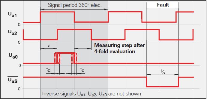

I am currently trying to make a VI to use with a linear scale. The linear scale gives 2 TTL signals that have an offset of 90°. The change in distance of the linear scale is given by counting the rising and falling edges of both signals. See the following picture: Ua1 is signal 1 and Ua2 is signal 2. You can disregard the other signals.
Now, I want to count the 4 edges in order to translate the 2 signals into distance. This means that I need two-edge counters for Rising-Rising, Rising-Falling, Falling-Falling, Falling-Rising for the 2 signals. I tried making 4 two-edge counters in LabVIEW but that obviously does not work, since only one DAQ can access the TTL card or I did it wrong.

Your linear scale is essentially a quadrature encoder.
There are a number of help topics on ni.com that will help you better understand the concept.
This would be a good starting point (http://zone.ni.com/devzone/cda/tut/p/id/4763)

I have used linear scales from Heidenhain in several applications.
As mentionned by the previous post, the output of your scale is like a quadrature encoder. Therefore you must use a counter input of the DAQ board to measure the position of the scale.
The desired X4 mode is done by the counter itself (not possible with some older boards from NI).
As a starting point, see Measure Angular Position.vi which ships with the LabVIEW examples. According to your linear scale, change the type of the polymorphic DAQmx Create Channel VI to CI Linear Encoder and the label of Pulses per Revolution to Distance per pulse.

In the mentionned example, enable the Z index and the counter will reset with the given value (z index value) each time the scale crosses the reference mark.
Notice that you must configure the Z index phase (levels of A and B when Z is active) according to the signals of the scale.
