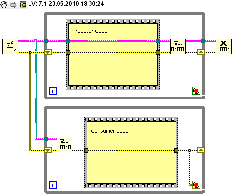

The producer-consumer design pattern certainly is one of the most important design patterns in LabVIEW. I'd like to discuss some advanced concepts when using this architecture.
Basics
Shown is the producer consumer architecture using queues (this is a flawed implementation showing only the most important aspects). In the top loop the data (for example acquired from a DAQ device) is enqueued. In the bottom loop the data is dequeued and further processed. To shut down the consumer loop, the queue is released resulting in an error.
22082iC0DF1566EC7D0232
There are several varieties of this basic design:
  • You can also use notifiers instead of queues resulting in lossy behavior
  • The data type can also contain a message (queued message handler), in this design the consumer loop is normally shut down using an exit message instead of the release queue.
The empty last element
If using the design above, the consumer will process a default element in the last iteration. Correctly instead of the sequence frame, the consumer code should be placed in the 'no error' case of a case structure. (see the last snippet)
