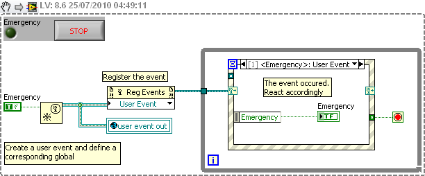

I already have a State Machine with an Event structure already setup to control the system. I don't want to add polling to make it work if I don't have to.
This is the best description of the functionality that I need:
"Is there any boolean flag or variable in the system (hopefully more than one) that can be set (and reset) by anywhere in the application, any VI, at any time; that can be detected as an event in a Event Structure?"

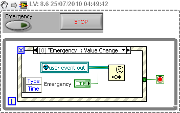

Can you use a Val(sgnl) on any Control or just stop?
What function is used to execute val(sgnl) ?
Message 13 of 25
(6,978 Views)
The png I posted is a snippet and is code. Drag it to a block diagram.
The value(signaling) property is the way to programattically fire a value change event. It is not limited to a stop button.

Accepted by dbaechtel
Define a user event as shown in the attached example, and create a corresponding global variable.
Use this global anywhere to generate an event.

Just what I needed.
THANKS.

How do I drag your code out of GMail and into LabVIEW?
I cn not seem to find a way to do it.
Message 17 of 25
(6,947 Views)
Direct dragging the snippet to the block diagram should work. Don't know how Gmail works, but you should have somewhere two files named "Generate Global event.png" and "Global event management.png".
Anyway, I have attached the vis.
Chilly Charly    (aka CC)

dbaechtel a écrit :
Missing code for Global eveny.vi.
Can you include it as well?
Global event.vi is just THE global. No missing code here ! 😮 😉
